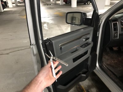

2017 here, had it happen to me last week. Was able to get the window all the way up initially and then drove 400 miles to Minneapolis and parked in a heated parking garage. Apparently the window was frozen up because when I backed up it fell down inside of the door, completely off the track and loose.
I had to disassemble the door panels and reattach it myself using only a leather man tool I happened to have in the truck. Took me about an hour and 15 minutes and a lot of swearing. I need to get it into a dealer to see if they have a more permanent fix, but it feels pretty solid right now. Honestly, the main issue is that the sensor that stops the motor when it feels resistance isn’t sensitive enough. I’ve had plenty of cars get frozen windows but most of them stop trying to lower immediately...
