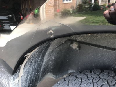

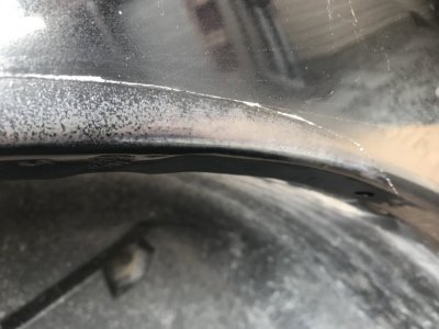

Here’s the damage:
Passenger front door, was repaired once already about 2 years ago. There’s a nice body line that makes this one easy to blend.
Passenger side rear wheel: Unfortunately a spot weld started rusting around year 4 so this has also been previously repaired. Not so lucky with the body lines so I’ll just try and keep it small.
Drivers side rear wheel. Also repaired once before.

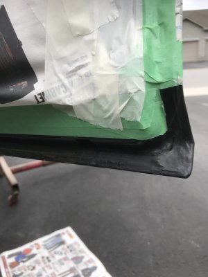

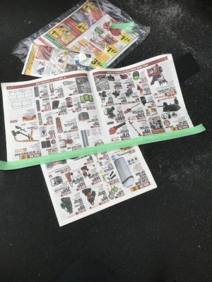

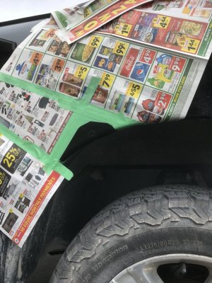

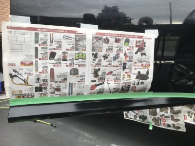

I usually mask, then prep and if the tape gets too chewed up I’ll re mask. Trying to blend with clear doesn't work very well for driveway jobs, you’re usually just left with two lines instead of one.

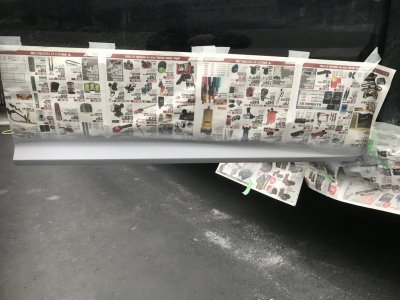

I just use news paper, I find this is the easiest way to attach large sections. Tape all seams otherwise overspray will find a way through and you will have to clay bar it off when you’re done.

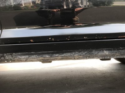

Also going over the passenger side rocker panel. There’s no rust my wife just drags her feet lol

Still more masking....this part sucks

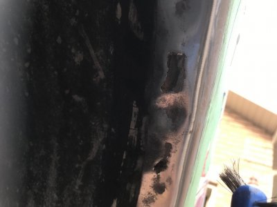

I’ll usually scuff the entire masked off area first with either 300ish grit sandpaper or red scotch brite. Once all the orange peel is off (next post) I’ll start digging a little deeper with the air grinder.
Fibre glass pens are good for getting into tight spots. If you don’t get all the clear coat off the paint will start to peel here.
Rust turned into holes unfortunately. I used a pick and some wire brush to scrape as much as I could. Don’t worry about being gentle.

An example of orange peel. If you see shiny, that means there’s still more clear coat to sand off.
Drivers side holes....I could cover it up with fender flares but I find they just trap moisture and cause the rot to spread even faster.

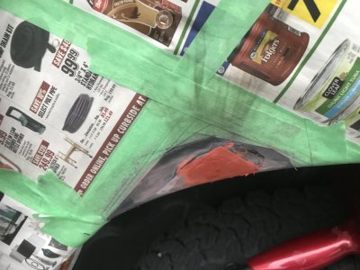

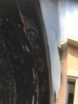

Passenger side spot weld that rusted through. You can see the body filler where it was repaired before. Just dig out as much rust as possible.
This year I attempted to weld the hole shut but even with my small flux welder the steel is so thin it just blew through. If I had oxy acetylene than maybe I could fill it, but I think I’ll just cut and replace this section in the next couple years.
I used 40 grit inside the door. The pinch weld traps a lot of moisture. Also if you use Krown or other oil coating, it’s a good idea to make sure the drain holes at the bottom of your doors are clear.
If you see areas that will require body filler I would start with them. Apply in thin coats and let dry and just build it up slowly. Also it shrinks when it dries so add more and sand it down.

If you’re priming and painting you’re good to sand with 300 grit or red scotch brite. If you’re just applying clear coat I would use 600 grit or finer, or grey scotch brite. Finally, before you start painting make sure to wipe everything down the degreaser, I find Goo-gone does the trick.

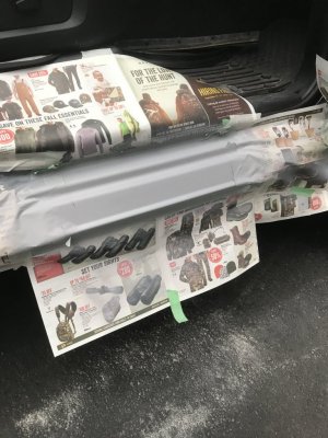

I started with two thin coats of Rust Oleum’s anti rust primer this year followed by two coats of the duplicolor brand sandable primer. After the 4 coats I did a very gentle sanding with 600 grit followed by one more generous coat. Just follow the directions on the can for time between coats and between painting.

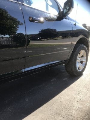

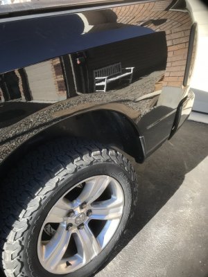

After a couple coats of clear, here’s the final product.
My kiddo wouldn’t let me take the pic if she couldn’t be in it lol
obviously if you know where to look you’re going to see the repairs. At first glance the average joe doesn’t notice a thing and I’m good with that.
