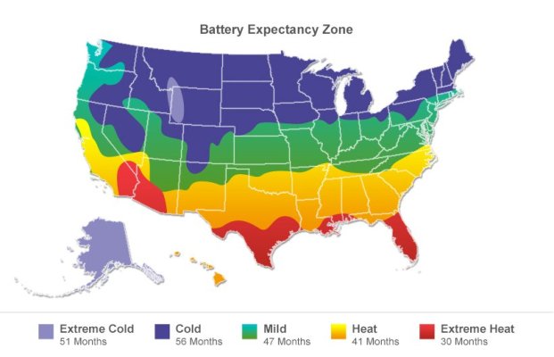

7 Years! Count yourself lucky, average is ~3 years in these trucks. Good on you for replacing the batteries, most people jump right to the alternator and starter and waste time and money, 99.9% of the time a no crank issue with these trucks is the battery. Always load test them, measuring the voltage is not a good test for them.
Yup, my local battery guy told me 3 years is about it for the factory batteries after I had to replace both of them in my 2022 Ram 3500. Same thing with my wife's 2020 Challenger, had to replace the battery when it was 4 years old and he told me we were lucky it went that long.

I'm here in the AZ valley with my 2022 2500 Cummings. I'm the original owner. 1st battery went at 15 months so it was replace for free. The second battery went right at 3 years. They just don't make them like they used to.
