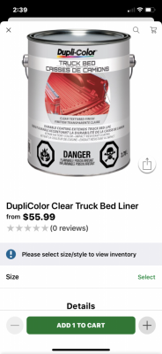

Anyone ever use the clear roll on bed liner from dupli color? 6B788770-3429-41D3-B342-7E1E43E54FCB.png I want to protect my box but would love to keep the red pearl showing.

I would seriously doubt it's durability. I think the spray in bedliners can be color matched.

I was wondering on it’s durability because you just apply it without scuffing the paint. Was wondering how well it would stick. I’ll either do a black liner or get a good mat to put in.

I did a roll on bedliner on a Jeep I had. In the end it looked like a roll on bedliner. I did the whole interior. It was ok for that application but it wasn't subject to the abuse a bed would get. I also did a U-Pol spray in on another Jeep interior which looked much nicer and seemed more durable than the roll on and I tinted it to match the exterior. That being said neither were anywhere near as durable as the spray in liner I had done in my Ram bed.
