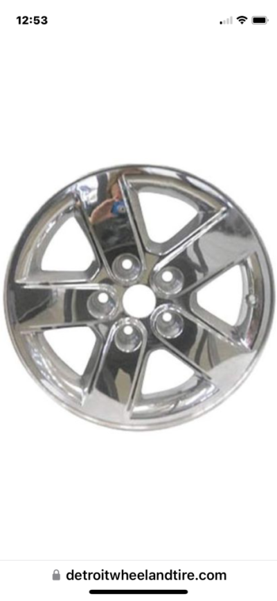

Looking at 2009ish Durango 18x8” wheels to replace my factory 20x8” on my 2019 Bighorn 1500 Classic. Same 5x139.7 but with +35 offset instead of +19 on my 20”. Can I use these rims if I use a 15 or16mm spacer?

I dont see why not, and for what it's worth I do like those rims. You should have no issues with 18's, so all that is left is having the right spacer. How much are those rims?
I thought the offset was way less then +35, are you sure? I put rebel knock offs because they were factory offset, my memory might be fading but I thought those were like +18.
I now see you have a 2019, that was the year it changed I think.

Durango rims priced 80-250 depending on condition. Offset on my 20” are +19; off set on Durango rims is +35 so need 15 or 16mm of spacer. I have a 2019 Classic. See new pic of inside of rim I want to use. I don’t see what could interfere with suspension or brakes?

Also chrome version of Durango wheel with same specs.
