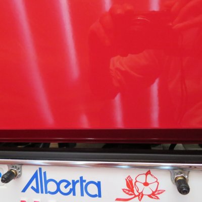

Run them as 2 seperate bags,don't "tee" them together.I mounted my fittings in the licence plate.
