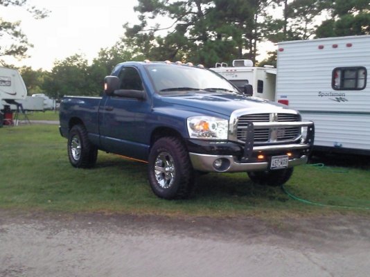

i have load range E on my 08 and i had load range e on my 03 reg cab 1500 a few years ago, funny thing was a lady flagged me down when i had them on my 03 and was telling me my tire was flat, when i pulled over it looked like it was low but not flat, and when i checked the tire it had 0 psi and the tire was supporting the truck just on the sidewall strength alone lol
they are a very tough tire, but def have some weight to them
