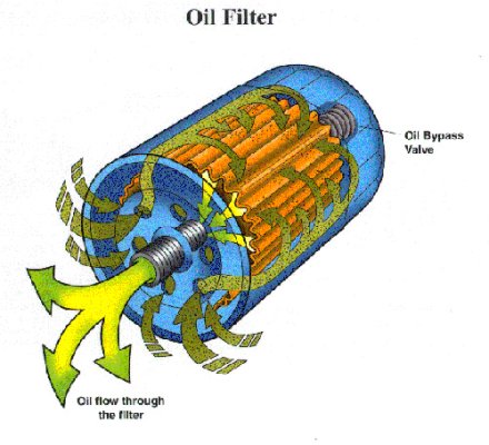

The oil that touches the sides has passed through the filter medium.
And that oil is moving.
Better to put the magnets on the oil pan and remove them before changing the oil.
Any filter i've ever seen, the unfiltered oil is fed to the outside of the filter/can then passes through the filter media and then out the big center hole. Unless you're running things backasswards from a standard filter,the unfiltered oil is against the can,and the magnets will attract the metal particles before they hit the filter media.
Why would you put magnets on the oil pan,instead of using a magnetic drain plug,magnetizing the oil pan still leaves a slight magnetic charge in the pan even after you remove the magnets,so magnetizing the drain plug is a way better option,as the particles stick to the drain plug ,instead of the oil pan,and can be easily removed when the plug is in your hand
