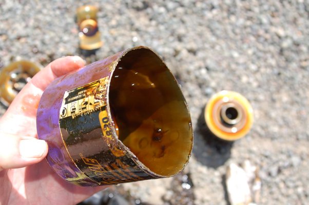

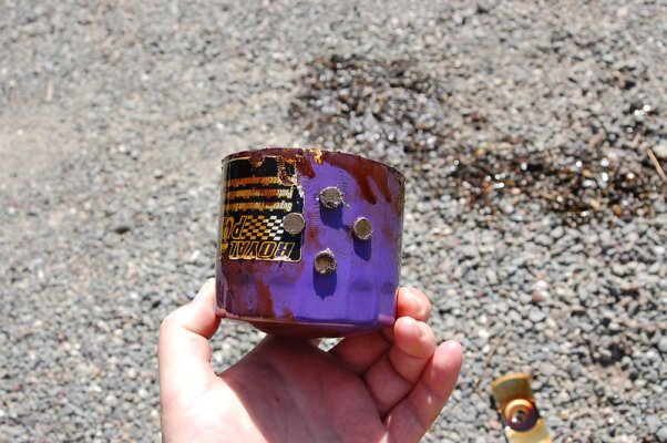

It's a good piece of mind, I was happy when I saw so little metal stuck to the mags, look at the rings or lack of rings. I had high wear in my uoa, which made me consider doing this to see how bad the situation was/is.

REference pictures posted by Burla above, please advise where magnets were and what you are trying to show. If magnets were on the outside of filter as they are shown in the picture I expect the metal shown on them now is from cutting the cannister in half and has nothing to do with the oil or what was in the oil. WHat might be adhered inside seems likely to be from the sawing too. Seems to me to determine anything you must take the can apart without creating swarf that can fall and be adhered to the magnet. A chisel like a t-profile muffler chisel or some kind of canopener type cutter are probably the best bet. REgardless the metal won't go through the filter anyhow. To get to the filter housing it has gotten through the oil screen and the pump. Seems to me if one is keen on the concept, which I am not, the only sensible way is the magnet on the drain plug. At least that has a chance of catching something that doesn't first go through the oil pump but is only likely to pick up larger pieces due to the motion and viscosity of the oil, even when hot small particles won't settle until you stop.

Try zoom, the magnets location and what they caught are shown. Had nothing to do with cutting the filter, that doesnt even make sense when you think about how a filter gets cut open and the metal circles. The metal circles on the inside of the filter is what matters, 4 faint circles and matches 4 magnets position.

You can see the rings versus what is on outside of magnet, one is shavings, one is microscopic, one is black and one is silver, one is from wearing engine and one is from the cut.

A proper filter cutter is much like a can opener, no filings involved. Look up oil filter cutter on Amazon.

The oil that touches the sides has passed through the filter medium.
And that oil is moving.
Better to put the magnets on the oil pan and remove them before changing the oil.
