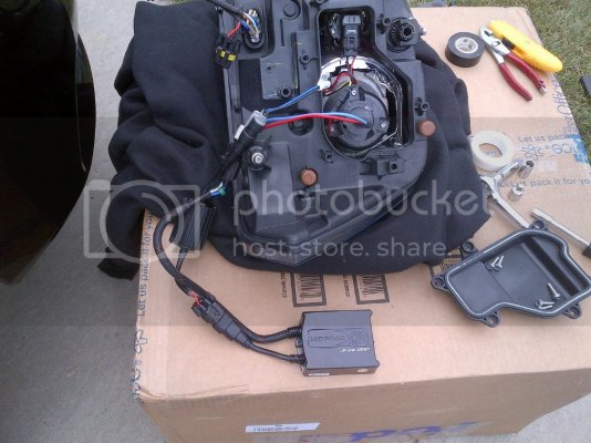

Most here are stuffing the CanBus Adapter and Ballast right inside the lamp housings
makes for a nice clean install without wires everywhere (need to Tetris them into place)

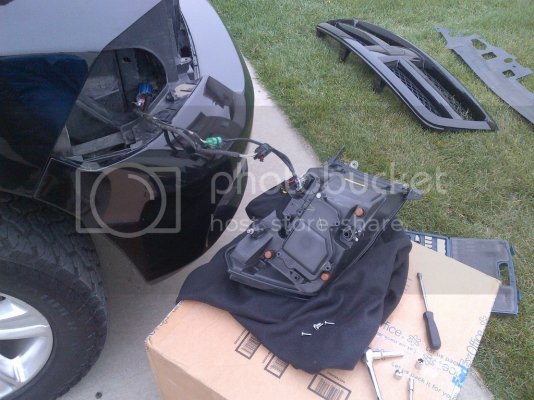

another recent install with Fogs too: http://www.ramforum.com/f41/retroshop_hid_headlights_foglights_install_photos-56216/

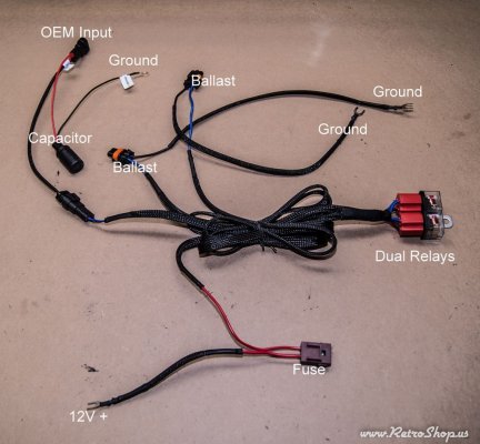

old school Harness:
ALL That,

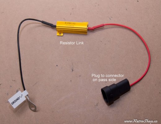

or a pair of these (for $15 less)
Take your pick ;)
