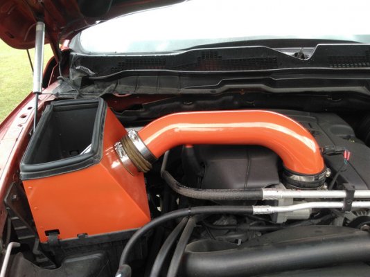

I see these $50 intakes on ebay and I wonder who has them. Is the intake piping 3.5in and mount to the stock airbox bottom like the afe ones do. If you have one post pics of how they actually look installed. I am interested in the fact of using the smooth tubing to replace the stock baffle tubing for better air flow from these cheap kits. If you use this kit do u really see a difference.

My buddy just installed this exact same one and it fits to the factory bottom air box. It looks identical to my spectre intake. Riding in his truck his gives a nice deep acceleration growl.

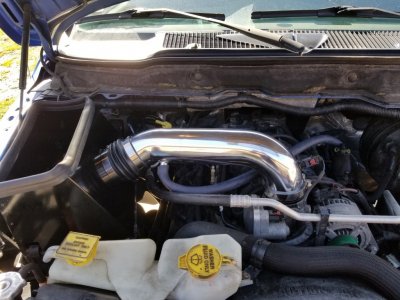

I looked at a bunch of the cheapo “universal” intakes (Spectre knock-offs) and all the inside diameter of the piping ranges from 3 3/8 to 3 1/2 inches. Upon further research and investigation, OEM tubes and aftermarket (S&B, Volant, AirAid, etc) use at or around 4” inside diameter tubing. I’m thinking of piecing together some silicone couplers (90* and 45*) and a length of aluminum tubing still that the inside diameter maintains a 4” ID from airbox to TB. I should be able to pull it off for around $50. I’ll get on it tomorrow.

Got the eBay intake in and installed snug fit IAT sensor is tight fit pipe was cold to the touch in cool weather. Build quality is better than expected
I also ordered the $50 EBay intake. I plan on installing later today. Did you notice any changes in performance and sound with exhaust? I’m hoping it will help my 18” Magnaflow breath even better.

I’m piecing 3.5/4” silicone (90* & 45*) and 12” of aluminum pipe to the stock air box and see how that goes. All told $40 for all including the (4x) clamps.
I also got a 3” Spectre duct piece to cut and drill into the bottom of the stock air box and run some more tubing towards the front bumper.
Will get parts on or around the 8th and will update how it looks and works. Although anything would lookand work most likely better than the ribbed OEM tube.

Installed mine last night. I must say for $50 I was very impressed with the overall quality of it. Installation went fairly easy except for the IAT sensor = TIGH! I love the sound of it, compliments my Magnaflow exhaust nicely! And I don’t know if it’s a placebo effect but it does seem to have given the Hemi some extra “umph” on WOT. Definitely worth the $50 to me!

3.3 inner is what my micrometer read id say the exact size of the tb opening. it would be easy to make a solid cover lid for this intake
