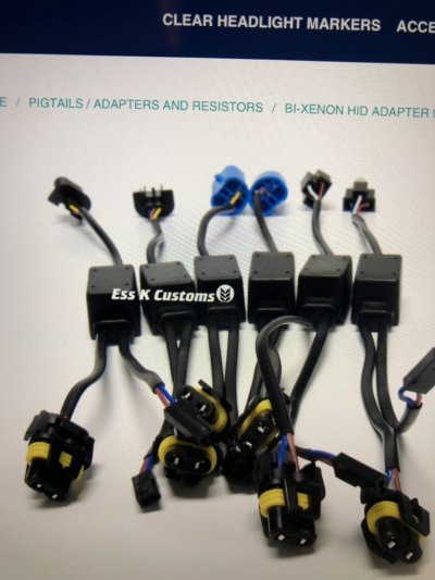

I ended up ordering a splitter harness. One end is h13, which goes to an h13 to the lights and a splitter 9006 for my high beams. Unfortunatly they were not assembled correct so I had to take the harness and re make it.
Was easy enough once I wrapped my head around it.

I love them man. They are awesome.
You can do a few different thing to wire them up. But I found the easiest was to use this harness, and just adapt the 9005 to my projector solenoid. Was easy!
You’ll need an H1 hid kit tho as that’s the bulb the headlights take.

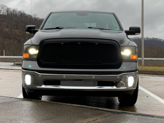

not sure how well this will show up, but I upgraded these headlights to 55w 4300k Innovited HIDs and put Hikari LEDs in the fogs.
