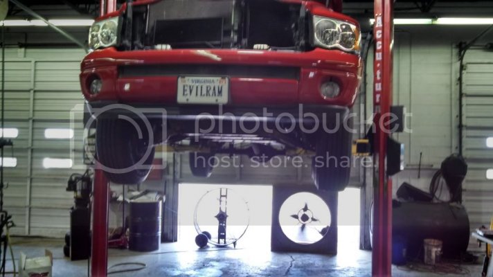

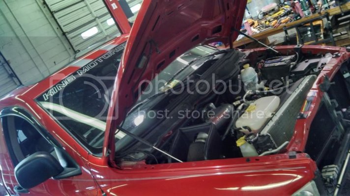

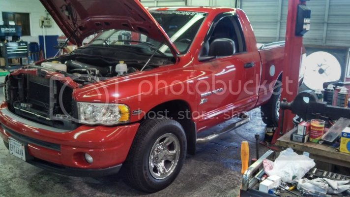

Yesterday got time to put in the new Edge 2800 along with the 1 ton trans cooler and take a look at the trans while it was down. Ordered it from Matt awhile back and it was sitting in the garage till I could get the other odds and ends together but well worth the wait. Having the band clamps on he exhaust was helpfull since all of it got dropped along with the rear crossmember but was still a tight fit with the transfer case to clear. Only put 50 miles on it so far and tried a few diff launches. I will say now leaving of idle in 4hi it PLANTS you in the seat. Last night the temp was 80 with high humidity and the truck felt great doing the 3 launches we did. 2wd is now just for show if I want to mash it.
Wanted to take some during pics but we were elbow deep for 3 hrs and didnt wanna get my new phone groody so here is all I have which is just the before.
Just getting to the shop and letting it cool alill
On the lift ready to get to wrenching. Started around 6pm and was on the street alill after 9.
