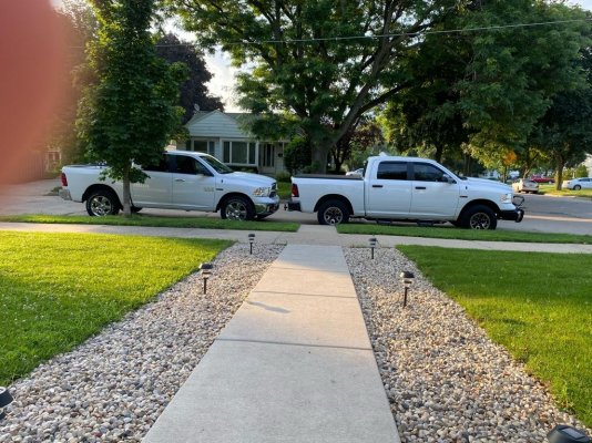

Pic for comparison
I tagged you in a listing in the for sale section. Worth a look for sure. There's absolutely nothing wrong with doin just the rear.
As for sitting so low, it's gotta be an eco diesel thing, my truck sat a good 1-2" lower than some gas models I compared it to. Never could pin point why for sure.

Those coils should be 1.5" lift. And being variable rate they should ride good. The eibachs are 10% stiffer than oem, and a 1"-1.5" lift. So basically both will ride about the same unloaded, and the ones I tagged you in can handle truck duties a bit better. I was actually gonna buy them, but my shocks are too long for that setup.
I don't get why our trucks sat so low, I have 1.5" rear lift and it's a tolerable rake with 2.5-2.75 front lift. But add some weight and I shoot nose up. Here's how mine sits e532d4313b82a0a4b2ecc341828df735.jpg

Man, I wish mine sat like that! Refresh my memory on tire size?
17x8.5 (or 9" I csnt remember) fuel anza.
-6 offset
315 70 17 Duratracs
Front 6112s maxxed at 2.3 + .5" spacer (spacer is 1/4" thick from R.C) 6112s had sagged to about 2"
Rear Bilstein coils (1/2" lift) + daystar 1" spacer and BDS 3" lift fox 2.0s
I'll be dropping to 285 75s on my next tire just cuz I don't want the width.
