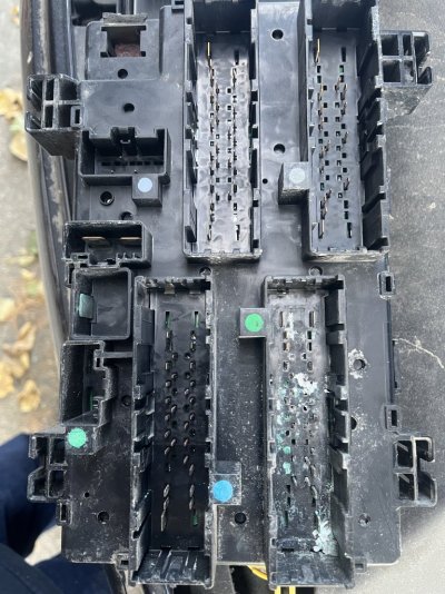

So it seems like the design for the TIPM is total sh*t considering it’s completely exposed to moisture and not sealed with a gasket or anything like that. Genius level design by Chrysler on that one. So a few of the fuses and relays did seem to be a little loose, I didn’t get a chance to fire the truck up after checking them earlier but I will tomorrow. The ground immediately adjacent to the battery looks pretty rough but isn’t loose at all so I’ll redo that termination just in case. Otherwise a number of the fuses appeared to be slightly weathered which I can only assume means it’s just as bad if not worse in all the spots I can’t see inside and below the TIPM. Anyone know if there’s an aftermarket replacement that is sealed up? Otherwise is there possibly a control module of some sort between the fuses and the dash that perhaps could be effecting the entertainment console controls?
Sorry for the ridiculously long post but the other thing I found is that the control arm for the parking break has a lot of play and wasn’t contacting the little mechanism directly in front of it below the dash. Has a wire that goes to it and appears to be some sort of super basic contact closure possibly to just illuminate the dash icon for the console. Seems oddly low tech for such an overly tech centric vehicle. And then the parking break cable is sagging way too low as well. Can’t tell if there’s a clip or something that fell out or if the cable stretched but I rarely if ever use the parking break anyway so… Digging up one more thing after another over here as I go.

I had the battery load tested and replaced it brand new before anything else. Right now I’m going through and cleaning all of the connections at the TIPM to eliminate corrosion and applying dialectic grease. We’ll see what all happens after this.
Great call on the TIPM being a horrid design.
It's quite unbelievable that there appears to be no effort to improve or replace the device.
It's a near-perfect example of a defective design and something that should be avoided because it is a constant common point of failure impacting multiple critical systems, especially with older vehicles.

View attachment 552421View attachment 552422
There’s your problem!
Yeah talk about a sh*t design. There’s 4 pins snapped off too so a new TIPM is the order of the day I’d say
