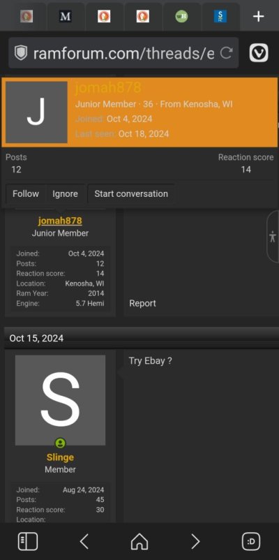

The OP'er hasn't been seen since October with no status updates on the fault.
