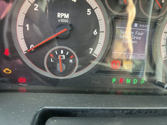

I unplugged both headlights, but the gremlin is still present. At one point, the gear indicator even changed color with a new error message.
The truck was in park, but it was reading as if it was in reverse. It caused my head unit to show the backup camera screen.

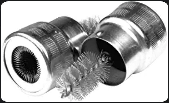

First, clean the battery terminals and clamps, and add a thin coating of dielectric grease. One of these cleaning tools is dirt cheap from Amazon or your local auto parts dealer and always useful to have. I try to clean mine annually at the very least.
