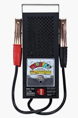

Load test the battery and have the alternator tested as first steps.
Preferably using a toaster-style load tester like this one. They're usually about $20 at HarbourFreight.
New batteries aren't always working and require the same test.
Most parts stores will test both for no charge but use a digital load tester that are prone to false positives.
Then the fun of testing & searching for unknown current on the battery after sleep mode starts.
