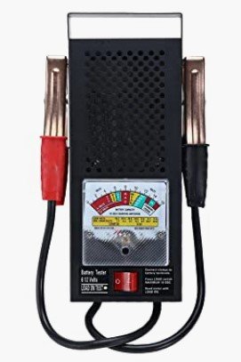

If the battery is about 3 years old or more, visit an auto parts store and have it load tested. I strongly prefer an analogue toaster-style tester because it will never lie and the digital testers have been known to be wrong.
Toaster style battery tester below;

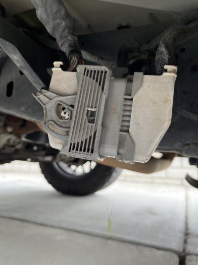

Yes I do, it’s giving me all issues that the truck is saying. Example, left turn signal out, fuel pump failure, fuel pump circuit high output. Etc.
the only thing I can think of since all of my problems are in the rear is this right here. I believe it connects all the electrical components to the rear of the vehicle.

YUP, there is also a Similar hookup inside truck to the left of the brake pedal on the firewall to the right of the E brake. There should be 1 big clip. My 15 ED had one, my 2019 5th Gen has 3 clips. U can disconnect, check all pins, and re-connect, or just verify both clips inside and out are connected properly, not loose. Was a known problems on the ED's. If U pull the connections, U may want to disconnect battery 1st, verify and reconnect. SOMEBODY better than me needs to chime in here on this before U attempt, just in case.

I'd agree with TB56, disconnect the battery and then disassemble and inspect both sides of that connector for water intrusion or oxidation on the terminals.

They need to check both the Interior and Exterior connections.
