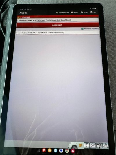

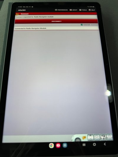

Classic. Im able to connect to body computer, climate, ect just for whatever reason not the radio navigator module on my 2019 8.4 UAQ with Navigation. Other radio settings in the body computer Ive made changes to in the past and no issues ever with pc or android. Using OBDLink M+ on latest version as well 5.9.4. I went to the 2017 radio navigator module var1 for my truck but also the other ones and no luck connecting to the radio navigator module. Anyone tried this on my particular year make and model with a 2019 8.4 UAQ donor radio. I just wanted to redownload the apps and see if that helped with vehicle user guide returning and maybe enabling the automated loudness setting. Thanks for any help in advance. Also never messed of touched any settings in the advance menu. Always have used regular without any issues.
Also before I upgraded two years ago my truck originally came with the Uconnect 3.0 for added information and my upgraded 7 inch cluster is working fine with vehicle settings ect.

Meaning the security harness bypass not necessarily to make those changes?

I can connect t to the radio module fine, just fails if I try to make a change. Are you able to change anything on there? There really isn't anything in there I need to change.
I was able to connect also without using the security harness bypass for 2018+ Rams and not able to change anything unfortunately.

Actually after reading this my harness doesn’t allow it to connect to the radio.
From the harness provider:
If you have a 2018+ RAM and would like to perform diagnostics or make changes to the modules of your truck using tools like AlfaOBD or AutoEngenuity, this bypass is for you.Does this allow access to all modules?It has been tested connecting to the BCM and RFH. Since it bypasses the security module for both the CAN C and CAN IHS, almost all modules should be good. The one exception is the radio. The radio does not directly connect to the either CAN of the truck, it is hung off of a DMZ on the security module to protect the truck's CAN in case the radio would be comprised via the 4G cellular functionality
