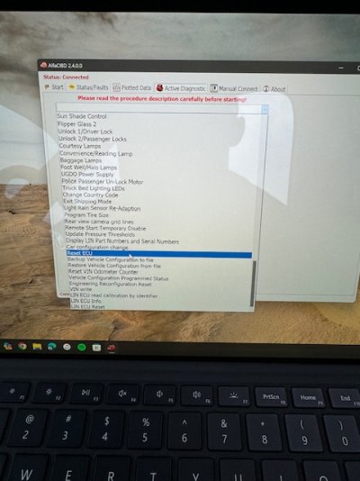

Just did the ECU reset with Alpha. We shall see.

Well that didn't work. I was looking in alpha at radio module and noticed it also has a ECU reset. Is that the same as the one on the body control ecu reset?
Also what does this function do?

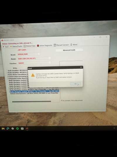

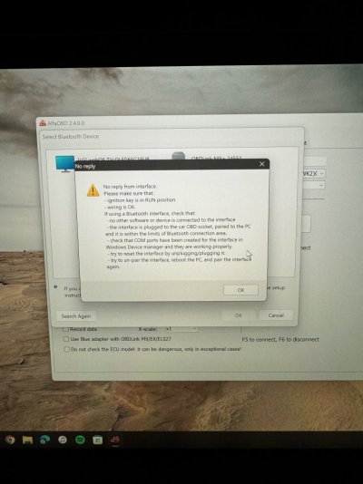

Yeah mines version 40.1. Still not able to
Connect to the radio module. Errors and everything has been updated, restarted multiple times.

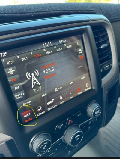

My Radio that has FM/Radio is in the Media and not in its own radio if you look at your screen you will see that you have a standalone radio tab with station and a separate icon for media. For some reason my FM /AM radio, usb/siruis, ect are in the media tab alone. I dont have the Radio tab unless that vanished and they grouped everything together in media tab in 40.1.
Also no more Vehicle User Guide tab for me even after numerous ecu resets and battery pulls on body computer with days waiting for it yo appear. Been a few months now since updating it vanished. I was originally on 34. Version but upgraded for the bug fixes in newer version.

The User guide comes up on mine, I did that today when I took the pic above. If I select the Sirius the icon changes to SXM and I still have a seperate Media icon as you can see. Strange that you lost that.

Mine doesn't have both, 40.1 UAQ doesn't have separate buttons anymore. Merged all to one softlkey based on which ever one you are using. Actually think when I upgraded I jumped to 28.3 and then to 40.1 and 28.3 already had this changed. Not sure about the manual. I know mine had it, but I never opened it so not sure if mine is there. Only annoying thing since upgrading is that when I am listening to SiriusXM and leave it on that when I power off the next time I turn the truck on it shifts me to presets 7 through whatever. If I listen to fm hd channel it doesn't change the preset screen when shut off. Guess it's better then people that kept losing presets after upgrading. Just a slight annoyance.
