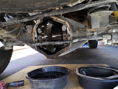

Pennzoil ultra platinum per owners manual and mopar gear oil. For the record I changed my diff oil and it was a waste of money as it looked new and nothing on the magnet.

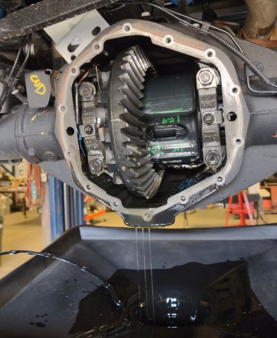

ditto, same here but was upgrading to aev diff covers, almost zero on the magnet. I see you removed the swaybar for better access....I should have done that, would have saved me some headache.

I’ m guilty of adding the cover too

yes just had to remove the 4 bolts and you can lift it up out of the way. less than a minute.
