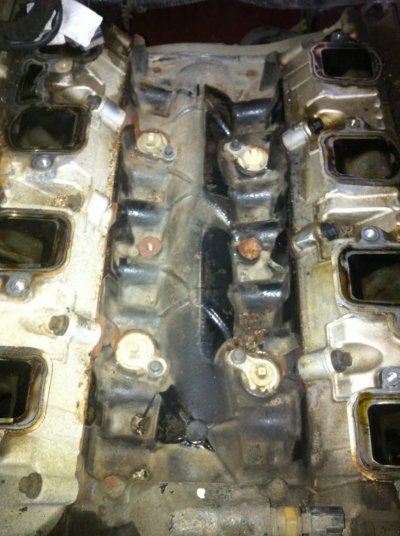

On your block you'll have 4 solenoids (electric valves) wich activate the extra oil flow to the lifters for the mds system. You would need to swap those solenoids and the lifters from your old block (if they are not damaged offcourse) into your new non mds block.
This is a picture of the mds solenoid blanking plugs on my 2003 engine (4 whit plastic caps with metal retainer plates in centre of picture), if you remove your intake on your block you'll see the mds solenoids instead of the blanking plugs like in the picture.

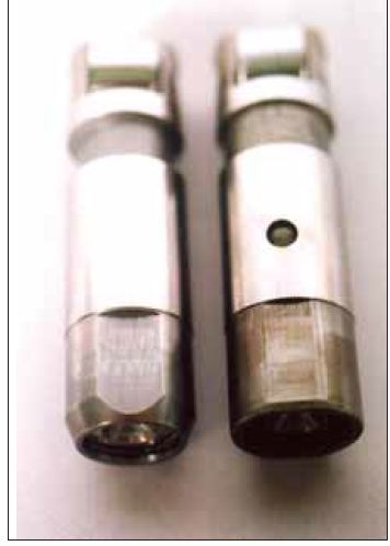

Left one is a non MDS lifter, right one is a mds lifter (the hole in the lifter allows the lifters internal oil pressure to be changend, oil flow to this hole is activated through the solenoid)
Disclaimer, this is all stuff I learned when rebuilding my 2003 engine, I haven't actually swapped mds parts to a non mds block, maybe you would also need different pushrods and other stuff? I'm sure someone else will have an answer for this.
