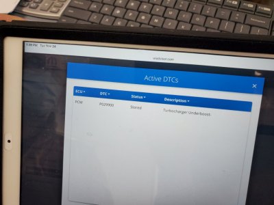

Driving my new 2020 Ram 2500 CTD (just under 2k miles), the orange "engine check indicator" lit up with an audible ding. This was about 5 miles down the freeway after leaving the wash-it-yourself carwash which involves use of a pressure sprayer. Driving was unaffected. Light stayed on for about 48 hours and turned off by itself, but only when I started to drive to the local dealership to have it checked! I went in anyway to retrieve the code:
P0299 - turbocharger underboost.
I snapped a shot of the service guy's screen (seen below).
I've been driving for an additional day. Light has not come back on. Driving well. I figure enough water got pulled up the air intake and into the filter to restrict airflow. Being that I am in Oregon, it's intermittently raining, and highs are in the 40s, it probably took a loooong time (2 days) to dry out and now it's fine. Any other thoughts?
Anyone know of a relatively cheap but good quality OBD tool to retrieve these codes? I'm willing to spend up to $80 or so if it's good quality and conveniently small.

Unless you blasted the water directly into the airbox inlets I doubt the air filter was wet enough to cause the problem. If the air filter was soaked, you'll see signs that it was wet.
Turbo underboost would be the ECM is not reading enough commanded boost. The ECM calculates the amount of boost then compares that to the MAP reading. The problem is more likely a sensor or turbo actuator.
