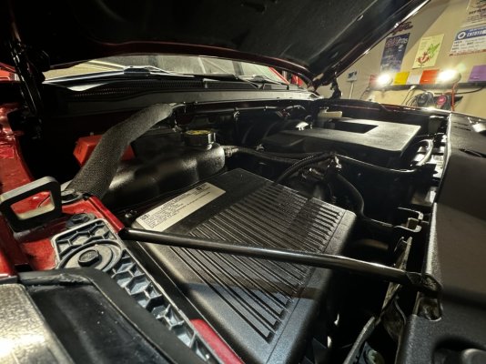

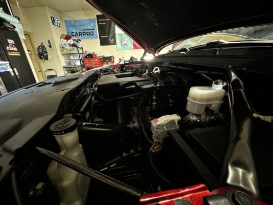

Here is the 21 Yukon with just a wash using Iron X Carpro Pink soap with American Detail Garage F bomb sprayed first and then I spray Koch Chemie Motor Plast or MP as its called on the bottle while its wet. As it dries it leaves it looking like this. Spray it drop the hood walk away.

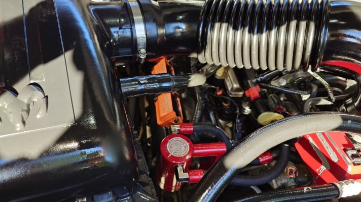

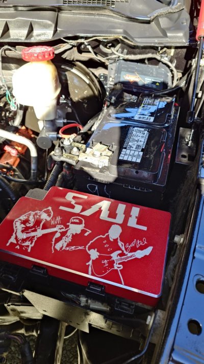

Just got my Billet Technology Engine detail kit complete. Took a while. Won it in a drawing for the military back in November. Took some time to get, but they (mostly) got it right. Working one issue - but highly recommend if you're looking for a way to "bling" up your engine bay!20241020_161804.JPG20241020_162012.JPG20241020_161957.JPG20241020_161946.JPG20241020_161758.JPG

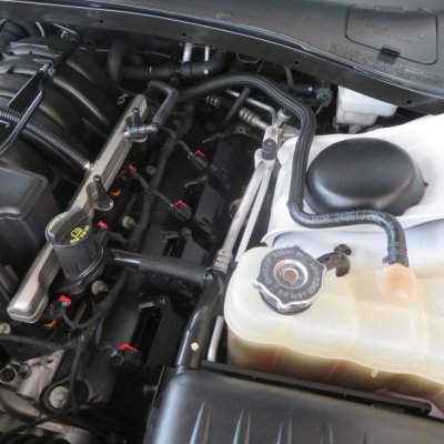

Motorplast has corrosion protection as a factor in it. It is really good stuff. Been using it a few years now and have a couple friends using it now as well.

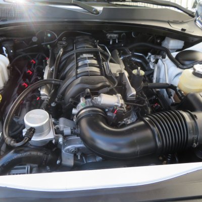

MotorPlast is your best bet for a true protectant that isn't some runny tire shine that attracts dust. I do my motor on my Camaro twice a car show season. We are in the last month of it here. It never attracts dust and it honestly never wears off. That is one thing I can almost bank on not having to touch each week before a show.

It looks good! People like to spray crap on it and call it good. There is an art to it. American detail garage F bomb in a pumper bottle and some good soap like carpro pink shine supply hot shot or p&s body wash with some detailing lug nut brushes and a a good wash mit then motorplast is all I do to get those dirty engines clean.

In all honesty I detail our engines like once every 3 months. Mostly just to get any splashed rain that got into the engine cleaned off. The top sides where you see most of it usually stay fairly dry. It’s the oil and grease from neglect that makes them look bad. I have a weed pumper sprayer that I mix this stuff in at 1:4 and soak the engine wash it really good with a good soap and brushes. Spray it off really good and then hit with MP at the end.
