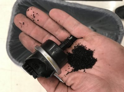

Filter
This is the filter from my break booster that plugged in the back of my carb.

crazzywolfie
Apr 6, 2013
16,646
3,430
under the truck
81 93
5.2
there shouldn't be a line between the carb and brake booster. you might be confusing it for the charcoal canister. it is on the passenger side fender right? a filter installed on that line is generally normal with age. most times when the filter in the charcoal canister fails it is easier and cheaper to install a cheap filter in line than it is to replace the charcoal canister or the filter in it. now saying this tho i would be wondering if there is possibly any charcoal in the carb. it could possibly cause some issues

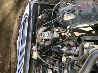

No. It comes off the break booster. The part name for the filter is break booster filter. It attaches to the back of my carb, and the pcv is on the other side.

You can see the hose starts where my speedo cable goes t's into the break booster, and plugs in the rear of the carb.

crazzywolfie
Apr 6, 2013
16,646
3,430
under the truck
81 93
5.2
you may want to make sure the lines are clear. there is no reason there should have been charcoal in that line or a filter on it. i am almost wondering if that thing that broke was possibly a check valve/vacuum canister. they usually have one on the cruise control so that it works consistently even when the engine is under load and not creating a lot of vacuum.
