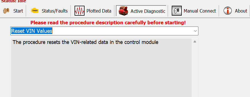

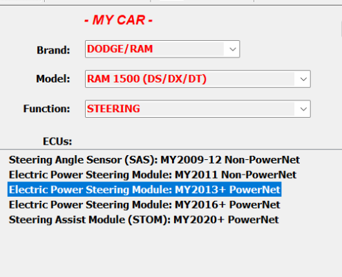

I believe that on a used unit, you will have to do the "reset vin values" operation with AlfaOBD. But, disclaimer, i've never done it.
