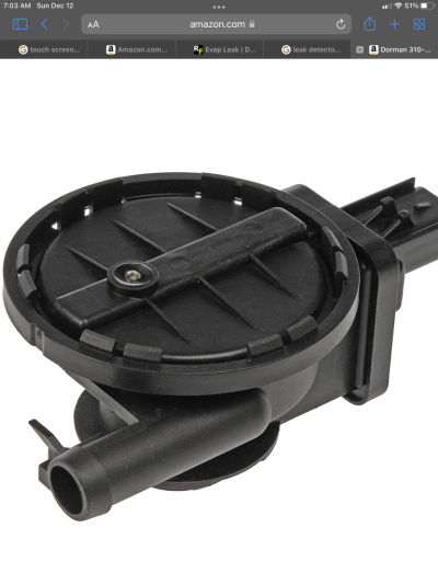

I have a 2015 Ram 1500 with the 5.7 hemi in it. The check engine light came on last fall and the code came back as a small Evap Leak.So far I've replaced the fuel tank pressure sensor,the purge valve and most recently the fuel vapor leak detection pump. Each time the code is cleared only to have the check engine light come back on a week later.I've spent over 600.00 and don't want to waste any more if I can help it.Does anyone have any suggestions on what it might be? Thanks for any input
1 year later, I finally found my leak. The new Leak Detector Module Pump has a snap on cover on the diaphragm. The cover was not secured properly and leaking past diaphragm

My 2004 was the snap on lid on the Leak Detection Pump Module. The snap lid on the diaphragm had a few clips not set fully and was allowing a leak. see Attached picture. It is the flat lid on top that was leaking.
