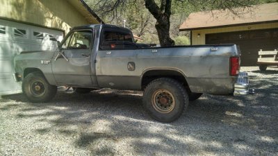

I currently own a 2018 Eco Diesel Laramie 4x4. I also own a 1987 W250 that my Grandfather purchased brand new, for $17,000 o_O. She's a little worse for wear, but one day I'll get it up and running properly.
