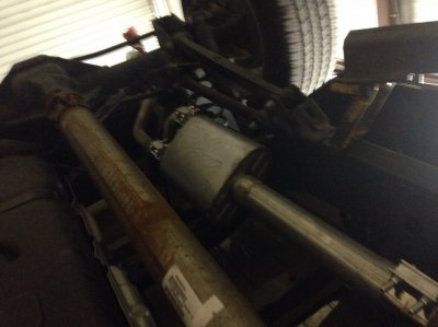

Welding is what I do and If I were you I wouldn't weld anything in the truck. Make it all bolt in so you can switch it back to stock or change the setup easy. Welding under the truck is hard enough to make sure you get it fully sealed let alone a novice with a flux wire. My suggestion is to do what I did I will include a few pics, you can make everything bolt in no welding even though I welded some on mine it would just cost you a extra clamp. Here's a few pics
Edit: sorry for the upside down pic... I don't get the iPhone from time to time some are right some are upside down..
