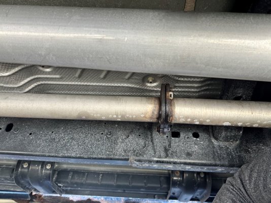

Hi guys, I have a 2021 ram 5.7 hemi 4x4 crew cab. I found the exhaust leak and decided i would address it myself, but the bolt snapped. It looks like the bolt backed itself out a bit which resulted the gasket being compromised as well. Is this issue possibly covered under warranty? Its directly under the front of the rear passenger door under the cab. If it's not, I have to drill the bolts out as I'm guessing the other will snap too. Thanks in advance for any help!
View attachment 538307View attachment 538308
My 2021 has the exact same issue at the exact same location. 42K on the odomoter. If I were to make a guess I'd say someone on the assembly line forgot to torque the bolts correctly.
