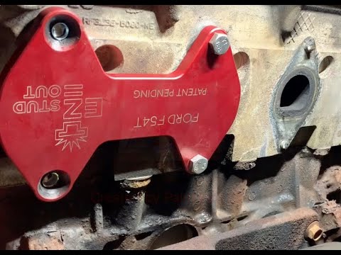

Here is a video about the welding method. They are selling a cool tool, but it's more about the job if you went that way.
