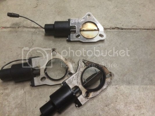

I have discovered that the QTP electric cutouts can't handle the new exhaust pressure of the F1-A Procharger. I blew out the set I had been running for 2 years just before the new blower went on so I replaced the butterfly valves with the kit from QTP. Well, new blower making 16 psi and a lot higher exhaust temps is apparently a bad combo for the QTP since I literally blew the replacement butterfly valves off so I replaced the entire assembly and bent the butterfly valves on the new cutouts in less than a month. Guess I'm going back to plane old bolt-on/off cutouts for track days only. I will miss them since I LOVE the cutouts, especially when I pull into shows or meets.

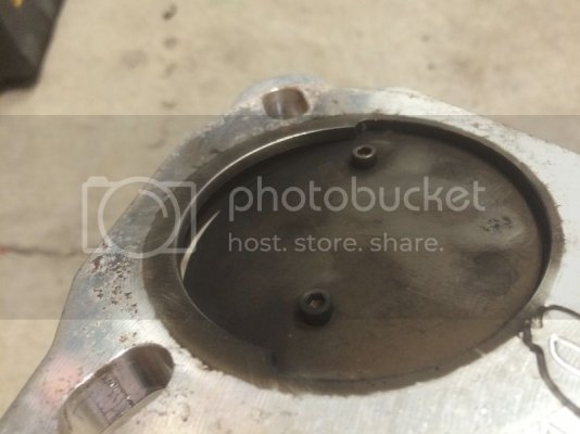

I never had any issues with them when I was low boost or N/A until after about 2 years when one plate started not closing all the way. QTP states you need to clean the carbon deposits out every so often, which I never did, but after a little WD40 and bristle brush they sealed up just fine again.
