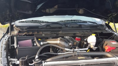

i was running a K&N intake which sat right at the top of the engine bay, wasn't really thrilled with it at all but I got a smokin' deal on it, took it off and sold it locally for more than I paid for it.
Just bought this el cheapo eBay kit that runs down toward the fog light, curious to give it a shot.

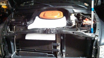

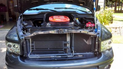

My solution to Gen III Air Grabber That Doesn't Exist
This is what I did. I love the Air Grabber, but they don't make it for my gen III so I grafted one to fit with a custom snorkel air ram scoop I made using the "lost foam" method. It not only looks old school, but it's functional and I have already seen an increase in my gas mileage from just adding the snorkel scoop. It feeds air from the high pressure area in the front of my grill as you can see directly into the air cleaner. It detaches with "mini push latches", real cool, just push the buttons in and the scoop lifts right out and then "snaps" right back into place upon return. I'm going to add a functional hood with scoop later because the Air Grabber has been modified to seal to the bottom of my hood, I had to build the seals up in order for then to reach the hood, but now there's a seal ring around the bottom of the hood where you can see where it's sealing. Feedback is welcomed, suggestions?

Dude. You did what ive been wanting to do for some months now. Except i was gonna make mine out of aluminum and pretty much make a funnel like you did. Still really sweet looking though. Nice job. I wanna go finish mine now
Tray Burge
Jul 30, 2015
2,752
3,426
On the porch
2003
Yeah, that was my initial idea, too much transferable heat. Plus decided I could get a better fit with fiberglass not to mention it looking a whole lot better. It also takes a lot of on and off fine tuning it until you get the right fit, I just don't think that's going to work with the metal. You wouldn't believe the difference the aluminum tape on the back makes! before the snorkel still got hot, now it's cool to barely warm after running the engine for a while, major difference.
That's the first 3rd Gen I've seen with a 4th Gen Vararam.
Here is the 3rd Gen Vararam: Hemi Ram Air
