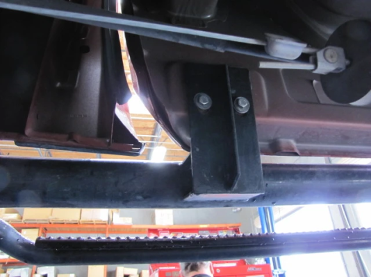

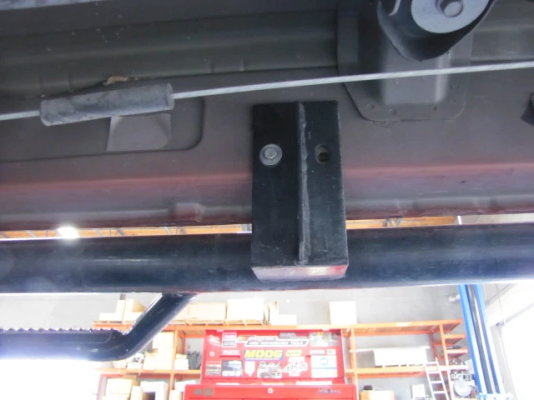

Then take a flat steel plate, say 2" by 4" , drill holes for 2 Grade 5 or 8 studs in each plate, as needed to mount the running boards.
Weld the studs in place & position the steel plates to fit the running board mounts & weld the plates in place
My Nerf Bars
