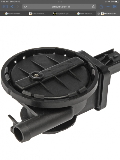

I have a 2014 1500 with about 48k on it and A couple of months ago, on a random hot ass day here in NJ, I left work, started my truck and *ding* look up to see my cel on.. ****.. grab my scanner (yes I keep one in my truck, who doesnt?) Scan, forgot the number but came up as small leak in evap system. Ok, gas cap... take off and put back on until click clicky.. clear code and off I go.. ran the full tank and it never came back on.. go get gas, ran through that whole tank and nothing. Cool. 3rd full, and a day or two after , light comes on again.. same code. Take the cap off and put it back on. Didn't have an issue after that.. well now it's happening more.. and its ******* me off.. aside from throwing money at it, what else should I be looking at besides a new gas cap (will be ordering one today) as to not waste money replacing everything until I find the issue at hand, if the new cap doesn't work.
The snap on cap on the diaphragm of the Leak Detection Module Pump on mine was not snapped on tight to make a seal. It is the flat top on the attached picture. I can’t believe I finally found my issue! It to sooooooo long to figure this one out. I hope this is your issue also
