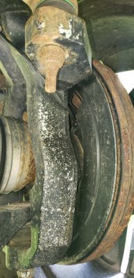

are these the sensors? i just took pics up front, im assuming theres some in the rear?

looks like breaks/rotor has to come off to access?
