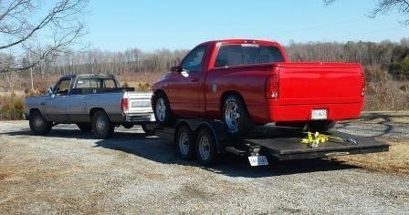

The factory hitch will handle it. This is my solution to towing.
