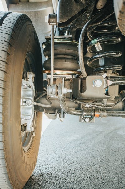

I'm sorry, I was using the term helper springs to describe those "sumo springs". I should have been more clear on what I was trying to describe, my fault.
Exactly correct. Not only to remake a 2500 into a 3500 (which was not my intentions) but even to purchase a gas 3500 over a gas 2500. There is no benefit except for a higher payload which I believe can be achieved by adding bags to the 2500 and achieving the same'ish spring tension as leaf springs.

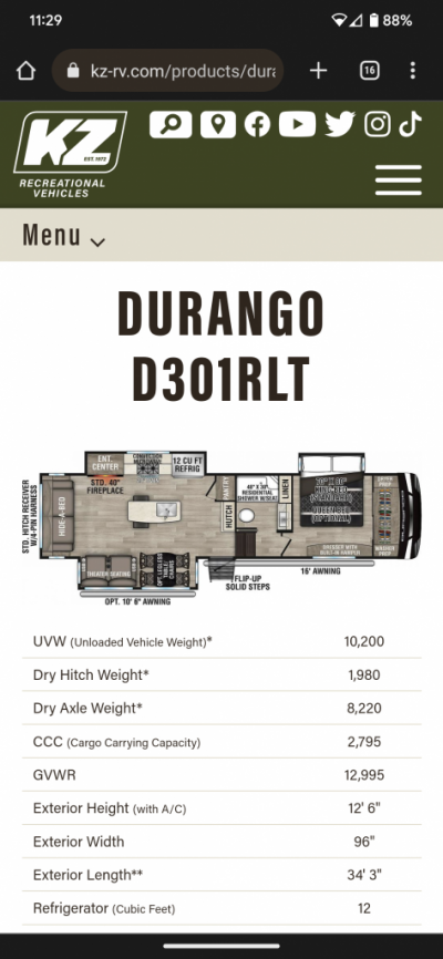

Again my 2500 will tow the 5er we are looking at getting. Personally I like a larger safety margin then what I have. Towing capability is not the problem, my truck can tow over 14,500 lb. The dry weight of the trailer I want is 10,200. It is the hitch weight which will put me to close to payload max depending on whether you go by GVWR or GAWR rear. I went to a local scale the other day to weigh my truck and 3 of us total included. With my front tires pulled off the scale, my rear weight was 3580lbs. Total truck weight 7700 with us in it. Going by GVWR that will give me 2300lbs. of payload I can add. Dry weight of the hitch is 1980lb. 2300-1980= 320lbs is all that's left for anything extra in truck and added hitch weight when trailer is loaded, which I do not know off hand what percentage of the weight is transferred to the truck and trailer axles.

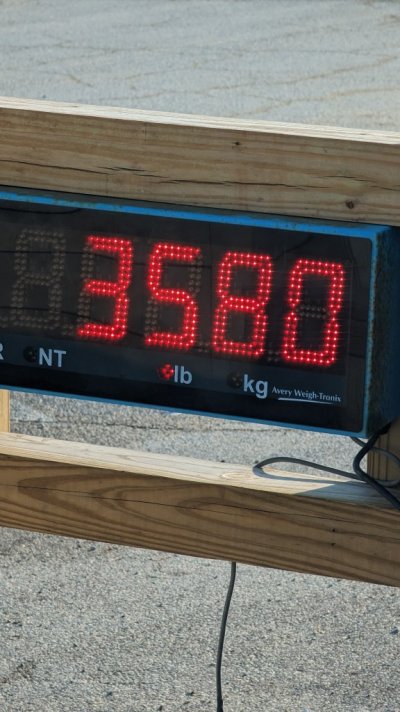

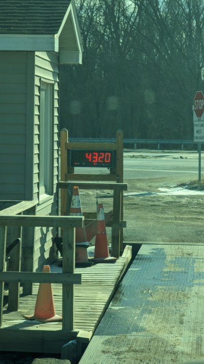

If I go by GAWR rear I feel more comfortable. Door sticker for GAWR rear is 6390lbs. 6390-3580= 2810lbs. 2810-1980(hitch weight)=830lbs left for extra payload.
So I'm going to try and guess high on these numbers 2000 lbs for people and supplies plus the dry trailer weight 10200 equals 12200lbs of total towing weight. Still well within range, it's just the payload that's making me rethink everything.

The issue between 2500 coils and 3500 leafs is the placement on the axle.
Sure you can add all the help you want...but the leafs are out farther on the axle aiding in high center of gravity loads. Like a heavy pinned 5th Wheel or large slide in camper.
There is plenty different between a 2500 and a 3500, but everyone wants a 2500 to be magical...and until the day the difference jumps out and bites you ..it will be.

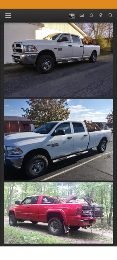

1. I own 2 leaf spring 2500 trucks. A 99 and an 03. The 15 with coils is worlds more comfortable and plenty more capable.
2. I do not want to pay the extra registration fee here in PA.
3. I could not have loaded anymore wood in a 3500 than my 2500, I have no intentions for a 5th wheel or a large slide in camper.Screenshot_20221220-121222.png
