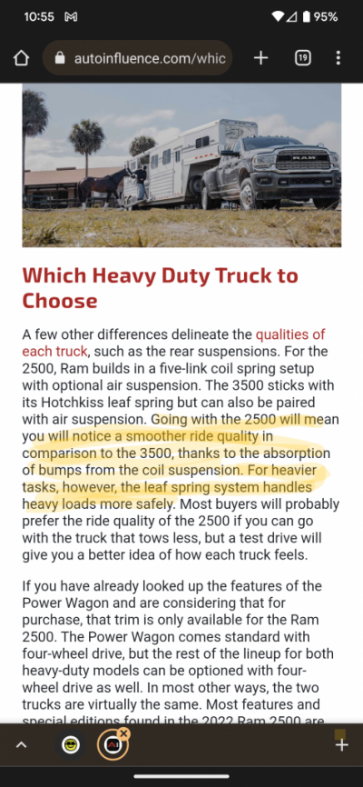

Going back to the very beginning, I asked WHY the 3500 is rated to hold more weight... I asked what the differences are in the truck BESIDES THE SPRINGS that enable it to hold more weight. I provided examples in best case scenarios between the 35 and 25, showing same model, engine, trans, 4x4 and rear, adding screenshots.
I ALSO said, Ram changed to coils to provide a smoother ride. (see the post DIRECTLY above yours).
I wanted to know if there are any differences besides the springs, so if I were to add supplemental support I.E. airbags, would the truck be just as capable as a leaf spring truck due to the extra load support.
I asked for sources, I was provided ONE source in this entire thread, which showed an extra cross member on the 35. However I found this diagram to be inaccurate because it clearly did not show the extra bars on my 25. (Scroll back, pictures attached).
From every forum and thread I've read through, this has been an unsolved question besides people referring to the door sticker. It has been proven the door sticker is arbitrary UP TO A POINT. I say this because you can register your truck with a higher GVWR in different states. I also stated that if the truck can safely have GAWR of 6000+rear and front is 5500+, the truck is clearly rated to hold more then 10000. Some say well if you have that much in the rear you have to take the weight off the front. I asked why, if each axle is rated to hold that much it can. I was replied with "the sticker said no more then 10000". Well here we are looping around again. "The brakes can't handle it".. so the brakes can't handle just a truck weighing 1000 lbs over GVWR, but are totally fine with a truck that weighs GVWR but is towing 15000 extras lbs? Ok.
I have no idea why most of you seem to be offended because I am asking for sources and not your "factual opinion". I am trying to get a mature group that can handle differences without getting their under wear in a bunch just because they can't back their opinions.
I never stated I was right, I just asked why... However you all behave like I'm arguing with you when I'm not..
Here is an example of a SOURCE which fueled my questioning. Here are screenshots with a highlighted section from said source. I'm hoping someone is able to find something that can prove different then this. It's not about being right or wrong, is about finding an answer.. if I'm on the wrong forum for that, I'll leave.

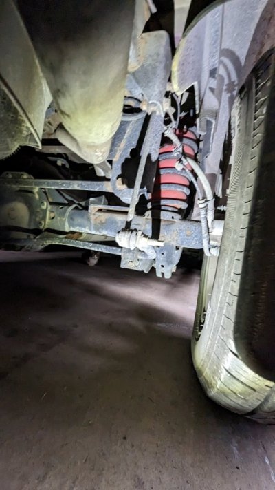

I mentioned it in one of the other posts but the coils being mounted inward in comparison to the leaf springs make it less stable side to side hence why the slip in camper guys regret getting a 2500 if they do any kind of long distance traveling.
For your farmer friend, his trailer is handling majority of the hay bale weight.
I'm sure the trailer is, but I'm also very certain it's way over payload.
I noticed that on his 1500 the springs were mounted far out, you can see in the picture. Literally where the bump stop is on a 2500. Which is why I posted the picture several posts back about the air bags replacing the bump stops on a 2500 creating better side to side balance with heavy loads.
