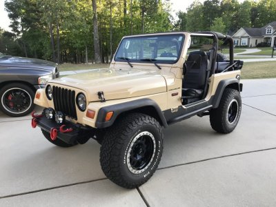

I've seen the hood pins on those hoods and they look good to me. Actually been mulling the idea of adding them to mine, but I'm old school and remember when all the muscle cars had them.
They were also the inspiration to putting them on my Jeep too.
