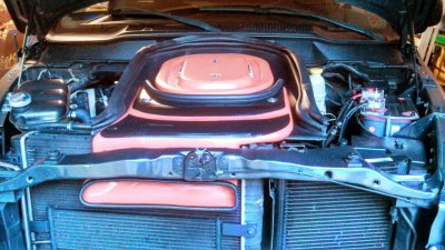

McGaughy's 2/4.5 with their axle flip kit is the way to go, that's how I did mine. Back is easy peassy, but the front spindles were a ***** because they are pressed on so make sure you have the right tools on hand. One I swapped out my stock shocks with upgraded sport shocks I quit bottoming out in the frIMG_20150905_094037_088.jpg ont and it handles like its on rails now. Well worth the trouble.

McGaughy's 2/4.5 with their axle flip kit is the way to go, that's how I did mine. Back is easy peassy, but the front spindles were a ***** because they are pressed on so make sure you have the right tools on hand. One I swapped out my stock shocks with upgraded sport shocks I quit bottoming out in the frView attachment 119505 ont and it handles like its on rails now. Well worth the trouble.
Tire size and roll pan used? Also, personally, how did you get the Vararam on there? Everywhere I look, I can't find a 3g ram kit for it...
Steel roll pan from Summit racing, 22"x10" wheels, and you won't find a 3rd gen Vararam that looks like this, I re-engineered a 4th gen to fit my truck and fabricated the snorkel scoop myself using the lost foam method.
