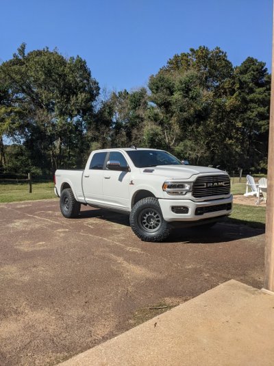

I managed to fit 37s on my old leveled 1500 so why not on my stock height 3500?
Specs:
17x9 +18 CJC exclusive Method 704 HD
37x13.5r17 Nitto Ridge Grapplers load range E

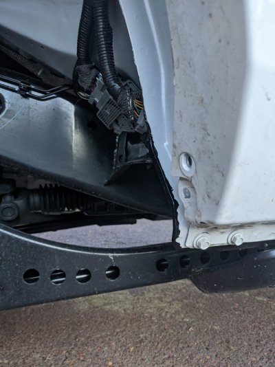

They fit really well. They do not rub the sway bar or the radius arms. The only spot that was an issue is the pinch weld on the cab.
Removed the wheel well liners and made quick work of it with a sanding disk on a grinder.
Final product...
+18 wheels have the perfect amount of tire poke in my opinion.

Oh also - I did not want to cut the fender liners because of the electrical connections that they protect. So I used a blow torch to mold the hump out of it where the pinch weld used to be.
