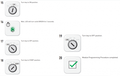

Hi guys, my battery drained completely and after jumping it, remote start doesn't work anymore. Do any of you know what to do ? Can I do anything or does it need to be taken out and reprogrammed again using my pc? I hope it does not as it was pain in the ass and I'm not sure where the cable is.

I have a CH7 and this worked for mine after I disconnected the battery for an extended amount of time. I didn't pull the lower panel off to see the green light....I just gave it a few seconds. This also worked for a friends 2014 Ram with a Flashlogic remote start too.
