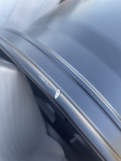

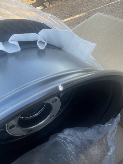

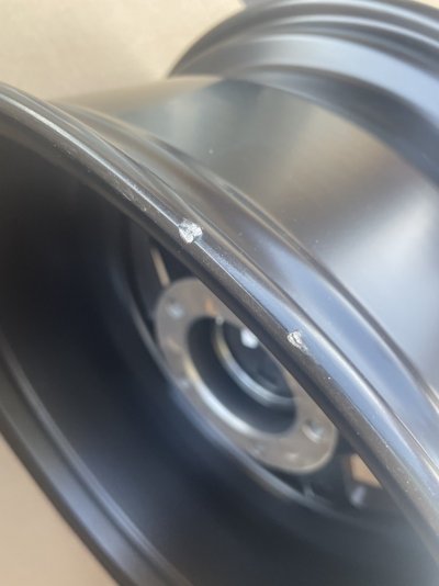

Got my wheels in today, I’m 99% stoked / excited.
They clear the calipers no problem, come in at 22.2 lbs, and have flat center caps! (Also one of my pet peeves are the raised center caps of the Moto metals).
BUT, all of the wheels have gouges in the finish that I can tell are from the hangers they used when coating the wheels. Yeah it’s on the inner barrels, but I’ve never bought NEW wheels with gouges in them like this before (or any wheel actually).

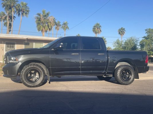

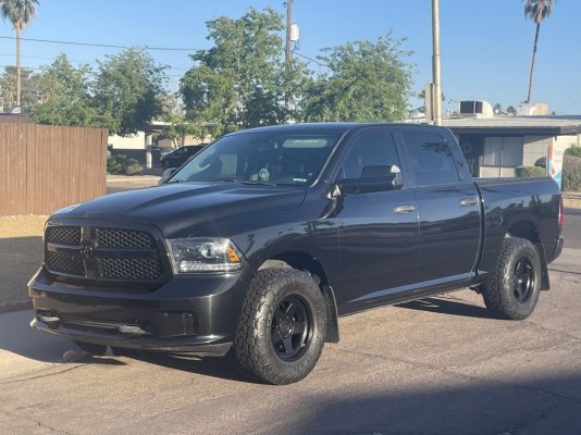

Here’s the new wheels and tires on.
I love them. Gives the truck an entirely different look.
These Toyo at3’s are f’n loud; way louder than the outgoing radar renegade rt’s; very surprising considering the rt’s are way more aggressive.
*edit* in doing more research seems like many on other forums have said they “hum” above 50… I dunno if “hum” is the right word. They sound like a dubstep song.
**2nd edit; they’re louder than my carven progressive exhaust… I dunno if these are gonna stay on the truck.
Anyway, gonna level it (already have 5100’s on the truck) and I think I’ll be super happy.
71lbs total weight of wheels and tires, down from 87. Should make a noticeable difference to mpg also.
