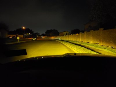

im using 2 rigid fog light pods, and 2 rigid driving lights in the fog light location using a dual duestch connector to the factory fog light plug. I think I bought my metal adapter on ebay.
the pic is with the fog lights/driving lights only on at night.

yes to mounting the pods to the bracket. it uses the three factory bolt holes i think i used the oem bolts to bolt the bracket up. i think it took me maybe an hour to get it all bolted up and plugged in. the most time consuming part was getting the pods aimed. im sure i need to try adjusting them a little more, but i dont really have a place i can do it so the truck can be level 15-20 feet away from a wall, garage door, fence or whatnot. i also put the yellow covers over the pods to give me the yellow color, they would have been white without the covers. correct, youll lose the oem clear lens, but the pods are so much better!
