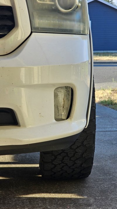

Hi all,
My fog light housings are all messed up (photo), so I ordered some new ones and installed, the mounting points lined up but the lights didn't seem to fit the hole correctly and there's a large gap between the light and hole face. (Photo)
I'm wondering if this is because the sport package has a different bumper or I'm not sure what the problem is. See photo.

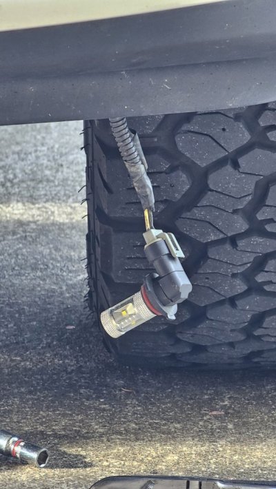

Also, my fog lights seem to be stock with LED bulb (photo) that fits into a housing and didn't have the correct plug for the lights I ordered, which are also LED but built into the housing.
Any suggestions or advice appreciated!1000002437.jpg1000002435.jpg1000002436.jpg

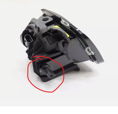

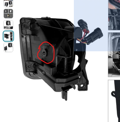

is this thing:
and this thing:
Some kind of adjustment screw?
I noticed that on the OEM fog light, there is something like an adjustment knob in similar locations. Did you compare the aftermarket Amazon lights to the OEM lights that came out?
The factory plug is for a 9006 bulb, the aftermarket should fit that type plug.
As for the gap on the side of the light, sounds like there's a mounting problem.

Somebody added those LEDs,as they never came with LEDs from the factory. I don't have many good pics either of my old sport,that actually focused in on the fogs.
