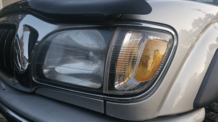

Automotive clear because of the high UV protection is best, yes. But last year I used an $8 can of aerosol clear when I did the Taco. Maybe 15 min of work each side.
This is the before. From the top down 3/4 was fogged out & crusty.
The after is a pic I took just now, so a year later and still looks mint. Especially for 20 yrs old.

Looks good,but honestly the bug spray cleared up my foggy lights better then that. My lights were in far worse shape then yours before hand,and by the pic,turned out clearer then yours are.So far i'm a fan of the bug spray,even if it only lasts 6 months i'm way ahead of the game,as it's just a matter of a quick spray again next fall

And don't get me wrong, I'm not trying to convince you. Just sharing for anyone that might want to try it. One note, if you're spraying the clear go light even coat. It will run fast. And can alligator when it dries. I might of done the passenger side headlight twice due to too heavy of a coat. So I probably got another 20 minutes into that side. Driverside though was one take.
They're clear as a sheet of glass. It's getting dark here and the flash drowns it out so that's the best I could capture. If I think of it I'll try in broad daylight tomorrow.
