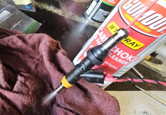

so when you back flush the injector, you put the spray can on the fuel outlet side and cycle the injector pulse?
I must have missed the procedure… Can we reiterate it step-by-step again for the process?so when you back flush the injector, you put the spray can on the fuel outlet side and cycle the injector pulse?
I flush them both ways,as it's just a pintle and seat,that'll flow either direction once the pintle is engerized and off the seatso when you back flush the injector, you put the spray can on the fuel outlet side and cycle the injector pulse?
Read the thread,everything is already pretty well explained,and there's a video in the first post that you can watchI must have missed the procedure… Can we reiterate it step-by-step again for the process?
Rick, that's one thing I did not do, I only flushed them in the forward direction. Hope I'm ok.I flush them both ways,as it's just a pintle and seat,that'll flow either direction once the pintle is engerized and off the seat
If they had a good spray pattern you're good to go Ed.i'm just a touch a-n-a-l about cleaning things like injectors etc,that's why i flush them both directionsRick, that's one thing I did not do, I only flushed them in the forward direction. Hope I'm ok.View attachment 574441

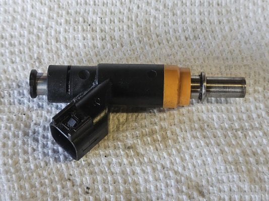

This is what my injectors looked like after 200,000 miles without being touched.
After cleanup:
