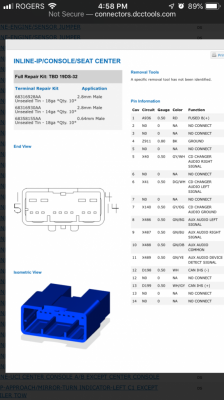

So this is the connector for the CD player
Where would you splice in the existing harness to get these connected etc
I’m guessing I would splice of this connector and run the wires to the CD player etc
Just don’t know where this connector location is
Must be near the front of the console coming up from the carpet etc ?

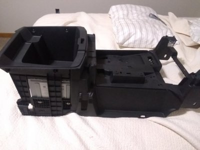

Does anyone know what the console harness part number would be for a 2018 ram 1500 with the heated seats and apple car play
This is a pic from my spare console so now I know what you mean .
Just need to replace the console harness

Which one? The one I listed for my console came right off the parts label on the bag.i got it from all mopar parts you have to enter the number and aa together to get it to show up.however this is not the harness you need i don't have heated seats.i take it you have the non console harness in your truck now and the cd console not in the truck also has a harness?if so just cut into the tape of the harnesses be careful not to cut anything.cut the cd plug with a good amount of wire lead off the cd harness and match the wire colors to your factory harness and splice them in.a pre 18 and 18 up harness both worked my cd player so the wiring for the cd must be the same.the cd player will power up and take and eject a disc without a flash but will not play until the sales code is flashed into the bcm.i was actually using a 16 ra4 radio when they flashed my truck and everything went fine.

IMG_20200329_193850354.jpg IMG_20200329_193145975.jpg there are seven harness for the 18. i use factory chrysler parts to look up stuff because their online lookup is better.scoll down and it shows chrysler brand icons click on ram then electrical and wiring console and it will list them.i included some pics where it branches.just swap your factory harness and lid to the cd console.the lid just plugs into the console at back so you won't have to take apart the lid

thats how the 99.00 cd base comes by the way if anyone wants to order one.minus the harness of course.

Tore into a cd harness tonight.the only two wires that tie into the harness are the red and black wires.the other wires are pinned directly off the console connector that hooks to the dash harness.but they are tiny pins and unpining them would be a pain ,5 wires.the non cd harness doesn't even have them.so one would have to unpin the cd plug and pin the other non cd harness.worth the 80.00 just to get the right harness.
